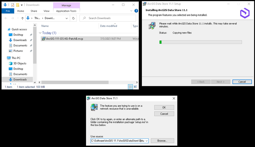

As an update, I tried to install the patch in question by downloading it manually from Esri's support site: https://support.esri.com/en-us/patches-updates/2023/arcgis-data-store-11-1-knowledge-graph-patch-810....
When installing the patch, in the course of the installation process a window appears requesting what appears to be the ArcGIS DataStore installation setup (C:\Software\ArcGIS 11.1\ArcGISDataStore\SetupFiles\), and the process fails and leaves the ArcGIS DataStore inoperable with the JRE folder empty.

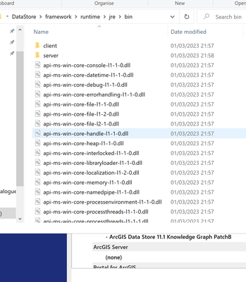

I don't have the Knowledge graph stored enabled but I'm able to see this directory:
As you can see, the patch has been applied successfully too.
Were your installations interrupted? It appears that the installation itself has corrupted and I would suggest running the installer in repair mode to, hopefully, restore this directory.

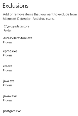

The ArcGIS DataStore is working normally and being used, so I see no need to perform any repair on the installation, and additionally this server does not have any antivirus installed, only Microsoft Windows Defender enabled with the default exceptions below:

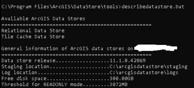

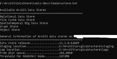

The test you did was on a clean 11.1 installation? Since all other installations of ArcGIS DataStore 11.1 that we have are the result of upgrades, where  the Knowledge Graph is available by default in the upgrade process.
11.1 clean installation:
11.1 upgrade installation:
