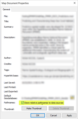

It sounds like you're not getting the references to the data set properly. The first thing for your colleague to do is to make sure the option "Store relative pathnames to data sources" in the Map Document Properties dialog is checked before he saves the project and sends it and the data to you.
