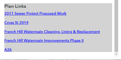

@JohannesLindner I wanted to update this post to reflect the newer, better option. With the Arcade Popup Element available in Enterprise 11+ and AGOL, I can now write one bit of code that will build a list of links flexibly and add as many or as few as there are intersecting:
var plans = Intersects($feature, FeatureSetByName($map,"Plan Area",['PlanName','Hyperlink','InstallDate']));
var sortedPlans = OrderBy(plans,"'InstallDate' Desc");
var planList = `<div style = "background:lightgray"><h3>Plan Links</h3>`;
for(var p in sortedPlans){
    if (IsEmpty(p.PlanName) || IsEmpty(p.Hyperlink)){
        planList += ``
    else{
    planList += `<p><b><a href = "${p.Hyperlink}" style ="color:blue">${p.PlanName}</a></b></p>`;
planList += `</div>`
return {
	type : 'text',
	text : planList//this property supports html tags
In addition to being more flexible, it's a lot cleaner and makes it easy to do some basic HTML formatting so it looks just how you want it. Here's the output:
