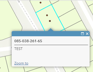

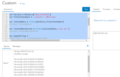

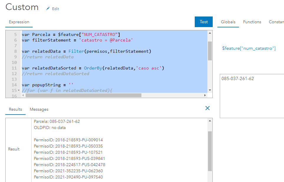

I can successfully test the expression in the dialog window.
But the popup just don't show the results expected.

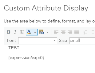

Is this expression actually {expression/expr0}?
Have you actually applied the popup config? The popup only changes after you click OK in the configuration window.
Have a great day!
Johannes
Ulises
Yes to both. Just added from the attributes list once created.
