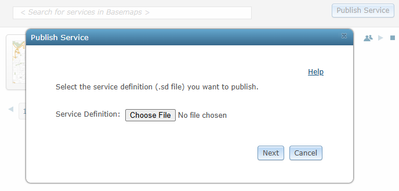

I have had trouble publishing larger web maps (100+ Layers) via ArcPro.  I've gone ahead and started publishing the 'Service Definition' as a file, then using the Server Manager to publish the service directly to the Portal.
Not sure how I would automate this, though I'm sure there's a way.
GarethFinney1
Thanks @D_Atkins
I was just in the process of tweaking a python script to create the .sd file via the .sddraft approach and then see how the publish step will behave across the variations I've tested with. The local esri rep here suggested I do what you've done also to test where the bottleneck is.
