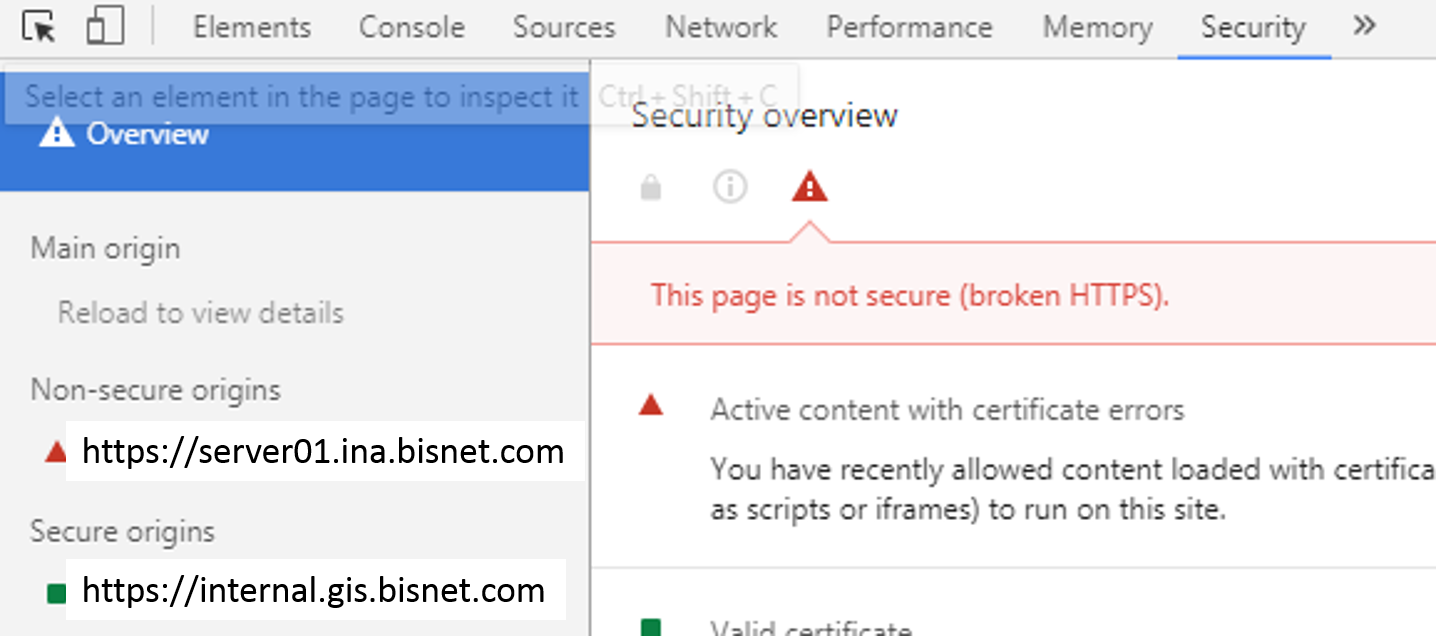

In Google Chrome Developer tools, I loaded the site to understand what insecure resource was being loaded.
  • It notes that my portal site (https://internal.gis.bisnet.com --example) IS secure.
  • However, it is also showing the name of the server that portal is on (https://server01.ina.bisnet.com) as an INSECURE resource. This is interesting, because everything should be coming through the portal URL (internal.gis.bisnet.com).

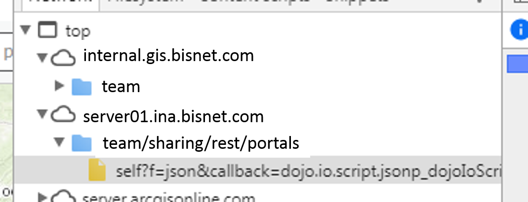

I took a look at the Google Chrome sources list, to determine what resource was loading from server01 (skipping around portal).
  • It might be an item from our Webadaptor (called team)
  • It appears to be something under the "self" properties

The response to the call to the SELF resource would be coming from the Portal.

If those are correct, I'd address this issue by adding updating your cert to include server01.ina.bisnet.com in the cert's SAN (Subject Alternative Name). I think that you're getting that error because the browser doesn't believe that the cert that's presented matches the hostname you're reaching. Setting the SAN would help correct that.

Have you set the webcontextURL for portal to point at the DNS Alias?  If not,  this could be why the requests are being sent to the portal machine name, and as a result, resulting in a certificate error, rather than being sent via the DNS Alias.

Philip's response above is going to be the best bet. I totally forgot about that setting. Updating the SAN would also have worked, but Philip's is the 'proper' fix.
