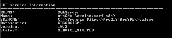

After installing creating the sde service successfully i received this information.  Now I would like to create an instance in this service.

The problem was that even with an SDE service installed, it would not start.  The message read the service started and stopped because it wasn't in use.  I have removed all SDE services.  My 10.1 service was not registered with Windows services either, after installing the 10.2 and seeing it as stopped as in the message above I was unable to alter any associated connections.

That's actually a different problem.  The service failed to start because you did not configure the Admin_database registry key (step 3 in the installation documentation -- If you're using DBO as the SDE user, then you may have skipped step 4 as well).  The Admin_database registration step is necessary on non-Oracle RDBMSes (it was hidden by the post-install UI, but it's always been there for those of use who used command-line to create services).
The command-line sdeconfig command, with Direct Connect syntax, would work even if the service was non-functional.
