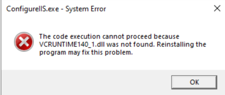

I am trying to deploy ArcGIS 12.0 in our development environment. We are moving from ArcGIS Enterprise 11.5. I was able to install Portal without any issue, but when I go to install the Web Adaptor for Portal I am getting stuck.
After running the downloaded ArcGIS Web Adaptor (IIS).exe file the Set Up Wizard does not launch. When I go to the downloaded files at the specified installation path and run Setup.exe nothing launches either. I tried downloading a fresh file from MyEsri and restarting the process, but that has not helped either.
I have checked and verified I have the correct .NET 8.0.7 and Microsoft Web Deploy 4.0.
I tried to manually run ConfigureIIS as outlined here: https://support.esri.com/en-us/knowledge-base/only-one-instance-can-be-installed-of-arcgis-web-adapt....
and received this error:
Any thoughts on what could be going on?

Hey @NICK_COG
On a few articles I found that the Microsoft Visual C++ files may be missing or broken in some way. I would try to reinstall the package from Microsoft to see if that gets things working: https://learn.microsoft.com/en-us/cpp/windows/latest-supported-vc-redist?view=msvc-170
You can also try to do the elevated command prompt one-trick wonder that never seems to work for me but others have had success using this without quotes "sfc /scannow" which could repair the file!

NICK_COG
That did it! Thanks a million.
