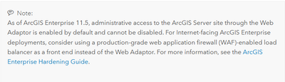

First, it was previously possible to disable manager/admin access via the WA.  This was something requested by many clients as I've gone through Penetration Test scenarios.  The check-box is no longer there.  This is somewhat concerning from a security standpoint.

The disabling of the admin access is now a 'deprecated option'.  It is now possible to manage a Map Image Layer (for example) in the Portal Items page.  This is going to centralise tasks and make admin lives easier.  To make that work, it's necessary to remove the option in the WA.  It makes total sense.  My only comment is that I've been through many Penetration Tests and C&A exercises where it was mandated that admin/manager access was disabled.  While I see the value of the new functions, I am cautious about the security aspect of this change.  This will impose a change on the secure environments that I have build and support.

As a wrap up of this discussion I raised a case with my local distributor under Esri Case #03919078.  I understand that the ability to disable manager/admin access has been removed by design and that the documentation will be updated to reflect this.

Esri updated the documentation indeed. We were in the middle of an infra uplift and now reviewing to include a WAF-Load Balancer in the equation. I've seen some architecture patterns including DMZ (F5-WebAdaptor)+Private(Portal+Server+DataStore).
Web Adaptor | Other web gateway options
And thanks for sharing your experience with the upgrade and the Edge bug too.
