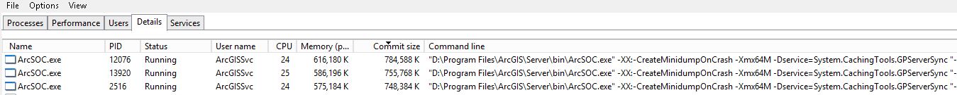

I wanted to share more info with everyone and hopefully shed some more light on why this is very perplexing...
i have two images attached...
1) AOI - this is running the "managemapservercachetiles" on level 19 whit an area of interest polygon
   a. there is very little work to be done with recreating all tiles within the area of interest.
2) ALL - this running the "managemapservercachetiles" on level 18 and level 19
   a. there is a lot of work to be doing recreating all tiles in these two levels
AOI - memory is running up like crazy and has almost maxed out the machine and is about to fail
   a. why would this smaller amount of work cause the memory usage?
ALL - the memory usage has stayed consistent at this level throughout the entire process, the cpu usage jumps up and down but i have always seen that behavior.
what in the world is going on?

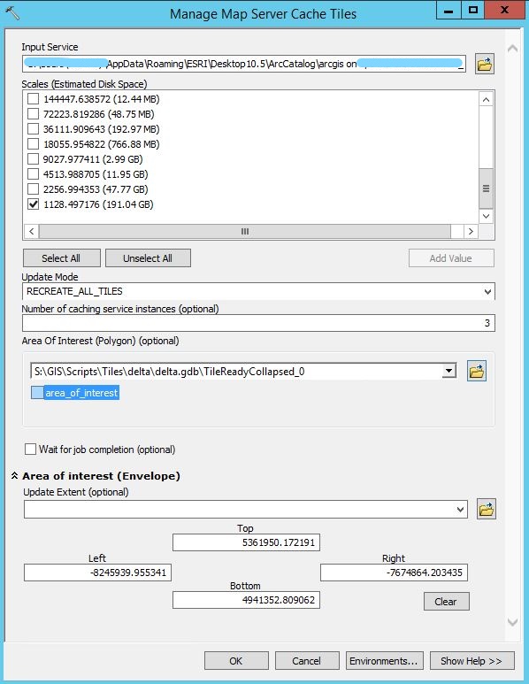

DaveTenney
here is the screenshot of the tool:
