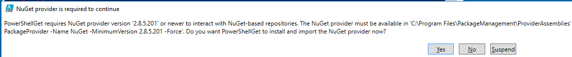

Find-Module -Repository LocalPSRepo
>> NuGet is required
I then get a pop-up window and error message to install NuGet:
>> PackageManagement\Get-PackageSource : Unable to find module providers (PowerShellGet)
PowershellGet.psd1 is installed @ C:\Program Files\WindowsPowerShell\Modules\PowerShellGet\1.0.0.1
## Get Packages
Get-PackageProvider -ListAvailable
>> NuGet 2.8.5.208
Any suggestions how to get the offline repository (LocalPSRepo) registered on the disconnected server,  is much appreciated..
