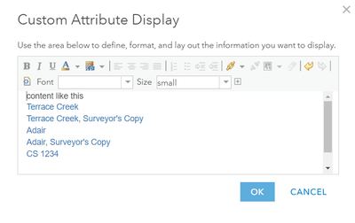

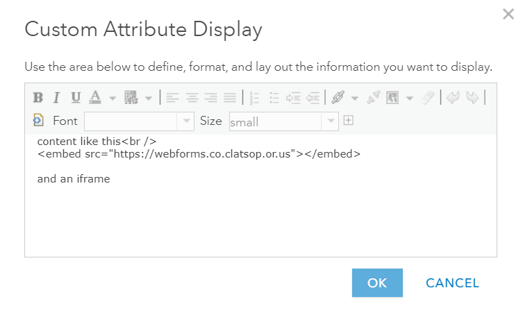

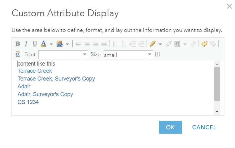

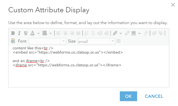

Here are some screen captures. Here is editing the popup in HTML mode

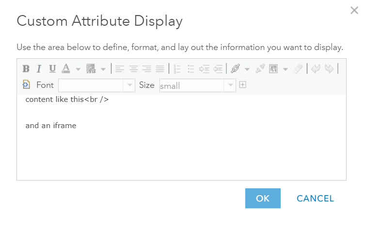

switch to preview mode and you can see the embed content is there. Scrolling down reveals there is no iframe content.
switch back to html and note the iframe is now gone
now if I save the map and reload the page, it has removed the embed tags too,
