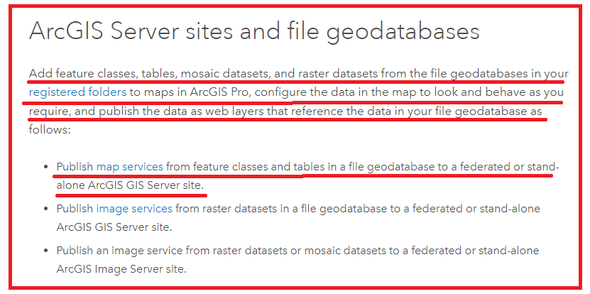

Note: you can publish the service without having to copy the data to the ArcGIS Data Store, like in "Hosted Services", for that you need to create a folder that ArcGIS Server can access and add the folder as a Data Store in ArcGIS Server, in that folder you can copy the File Geodatabase or any other data that the map service needs to access, then during publication choose the option to not copy the data to the server.
File geodatabases and ArcGIS Enterprise—ArcGIS Server | Documentation for ArcGIS Enterprise
Disable automatic data copying when publishing to ArcGIS Server—ArcGIS Server | Documentation for Ar...
Copying data when publishing to ArcGIS Server—ArcGIS Server | Documentation for ArcGIS Enterprise
Data sources for ArcGIS Server—ArcGIS Server | Documentation for ArcGIS Enterprise
