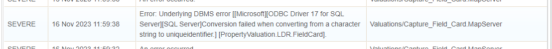

Hi,
We are working in ArcGIS Enterprise 10.8.1 on Windows.
We are getting an error in our ArcGIS Server Log:
When we trace that back to the IIS logs via the Site admin logs, we find a query in the IIS logs like this:
 cs-uri-query:
 f=json&where=GlobalID%3D%27null%27&returnGeometry=false&spatialRel=esriSpatialRelIntersects&outFields=OBJECTID%2CSGCode%2CCadastreDate%2CGlobalID%2Ccreated_user%2Ccreated_date%2Clast_edited_user%2Clast_edited_date&token=c4UIGaj-ZopDMQJcAELgDnEKunP5qxETc69ijuEVynAEnhrcIRUymSiUVDUHdDv2R-9tolTAuLLSUi4DEoISRI99Hf0cIq2x2uBjGYqbV2YQo0re7HutHbQ_494kGht6cz6LM-sKJO3Dm582mm0DOnJCX8jhsk4QigQWd3rXCkio_VWy_yEuB2jP26al3RvOPv0K_sxvgGhEth8h-5IU9Mo2sPzoA1ZfHGQuzhdDjDgNd0vjViYwRdNYNOA9vszGnIqoC3LD0UIJV6QT7Rz33P9uLVA-B6rHTxVjLBNQPsI.
This translates to whereGlobalID="null", which seems to be the generator of this error.
Does anybody know where this is coming from and if we can do anything to prevent it from occurring?

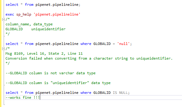

MarceloMarques
You can check the source data in the SQL Server Geodatabase, open SQL Server Management Studio (SSMS) and run a SQL query against the Featureclass table to find if there are any rows where GlobalID is null.
Note:
Where GlobalID="null"      ( this is searching for a string value "null" and not searching for NULL values )
Where GlobalID is NULL  ( this is searching for NULL values )
If the Featureclass is branch versioned then you can query using ArcGIS Pro or via SSMS.
If the Featureclass is registered as traditional version and you have versions child of sde.default, then some data might still be in the delta tables after the reconcile and post to sde.default and only a sde compress will move the rows from the delta table to the base table, hence you can query the Featureclass using ArcGIS Pro or you can use the Featureclass EVW view (multi versioned view) instead of the Featureclass base table.
I hope this helps.

MichaelMorgan4
There is a query somewhere in the Capture_Field_Card map service that is checking the GlobalID field for the string 'null', but GlobalID is not a string field, it is a "UniqueIdentifier" type. This field should also be set with a "not null" constraint, meaning that no value in the GlobalID field would be null. To check for null values, the query should be "WHERE <field> IS NULL" (capitalization not necessary).
MarceloMarques
@MichaelMorgan4 - good catch! 👍
| Marcelo Marques | Esri Principal Product Engineer | Cloud & Database Administrator | OCP - Oracle Database Certified Professional | "About: In 1992, I embarked on my journey with Esri Technology, and since 1997, I have been working with ArcSDE Geodatabases, right from its initial release. Over the past 33 years, my passion for Spatial Databases and GIS data has become a central part of my career.." | “ The mountains are calling and I must go.” – John Muir |
