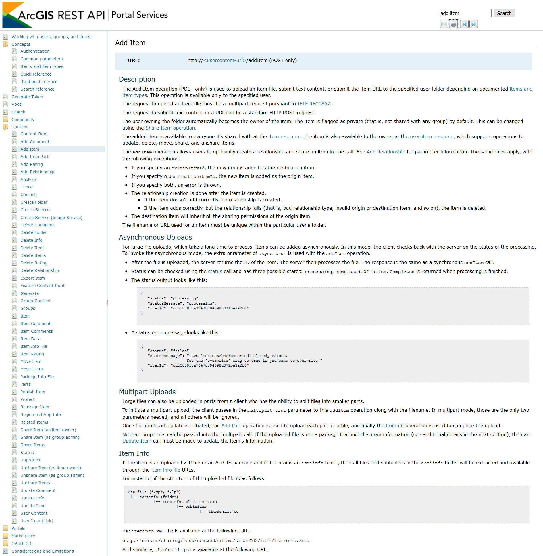

Are you mimicking the parameters used when going through the workflow in the browser with the dev tools or Fiddler running?
KarolHerszfeld1
I am trying to use the Portal REST API and the POST method to add item to the Portal following the API reference I have:
REST API reference
Same thing can be achieved for one file trough the rest directory, but only for one file at the time:
REST_AddItem
I have found module from ESRI on GitHub that have "AddItem" function which is basically what I am trying to write myself. But I need to dig into that..
