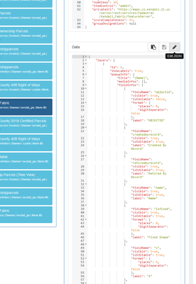

Also, can you confirm whether or not the field is present in the service JSON at web-adaptor/rest/services/path-to-layer/FeatureServer?f=pjson
If you're comfortable with it, try editing the service defintion directly to add the field. You can use AGO Assistant to do it. I've had other layers (hosted, not server-based) where I had to add a new field via the JSON directly, and it worked.

I do not see the field listed in the service JSON.
Thanks for troubleshooting with me. I may have to open up a ticket, as I'm at the limits of my knowledge on the subject.

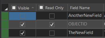

I've done a few tests with Pro 2.7.1 and ArcGIS Enterprise 10.8.1, and while I've seen inconsistencies in the way that the addition of new fields manifests in Server/Portal, in general it has worked with just a service restart (i.e. not republishing the service).
A few things to check:
1) Is the new field being flagged as visible in the Fields view from the map that you're publishing?
If not, then it won't appear in the service definition.

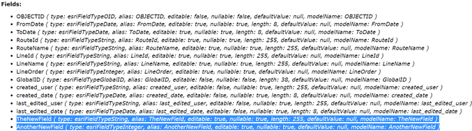

2) Do you see the new field listed in the rest endpoint for the map/feature service?
3) Has the field been added but is just not visible by default in Portal (e.g. from the Data tab on the Portal item page)?
Something that I've seen with a fair bit of consistency is new fields not being made visible by default.

Just wanted to give an update.
I came back in this morning and checked my service to find the new field now shows up!
We do have a nightly script running on our server that stops and starts all map services, but I was stopping and starting services when I was testing the addition of the new field yesterday....
I wonder what tripped the change this time? Or maybe there was some lock on the feature class somewhere? I wouldn't think it would be a performance lag from our remote server, but I'm not sure...
Anyway, thank you all for the help. It seems resolved for now, but I'll post any updates if I can pin down any other reason why it wasn't working.
