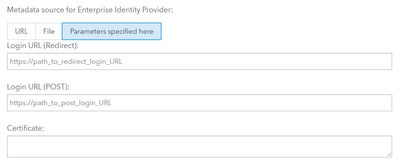

The configuration of SAML is done through the following options:
1. Using the IDP metadata url
2. Using a metadata file
3. Using parameters
The first 2 options should automatically import the correct certificate key. Sometimes that certificate is out of date or wrong, so you can manually update it by editing the SAML configuration.
The last option will allow you to specify the certificate key directly.
In my experience it is much easier (and foolproof) to use an IDP metadata url or file, as this will automatically populate everything for you.

We have used the parameters option and manually copied the certificate from IDP metadata file (there was some an error coming when  importing the metadata file)
