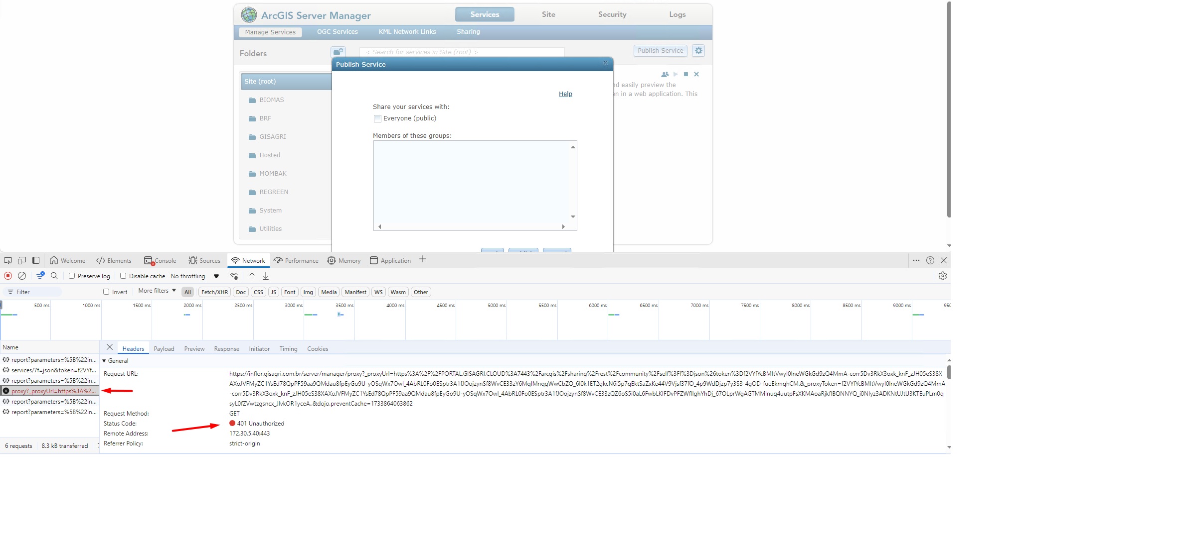

I'm having a problem when trying to publish data to my ArcGIS server. When the existing groups should appear, nothing appears and the error attch1.
I verified that the URL used in this PORTAL.GISAGRI.COM link works but it gives an unauthorized error.

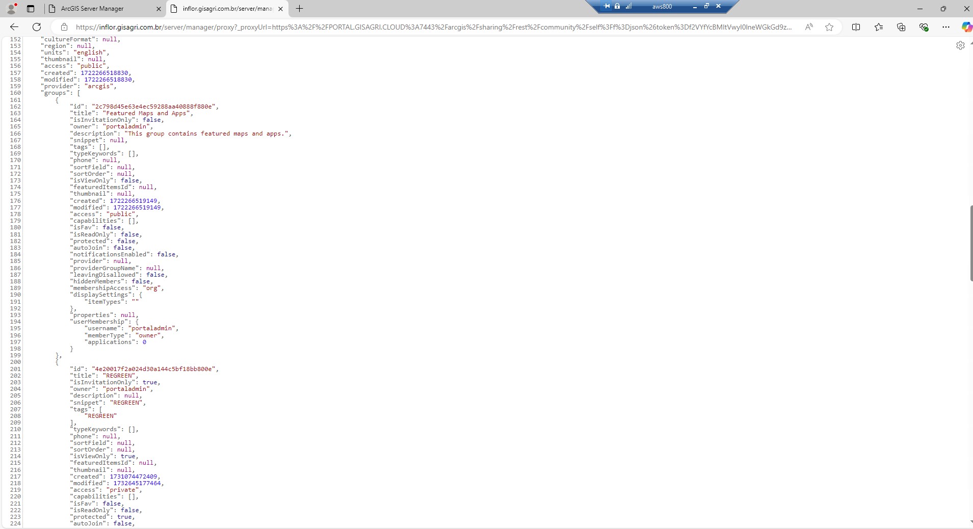

However, if I take this URL and enter it in the browser, it searches for all items correctly.

are you checked the federation status between you server and the portal? is it ok?
GustavoMartineli12
Hello,
Yes I cheked and is ok
