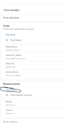

EmilyGeo
Hi @doronwen
The workflow posted above enables you to navigate related records in the pop-up.
This article will walk you through configuring forms for editing related records.

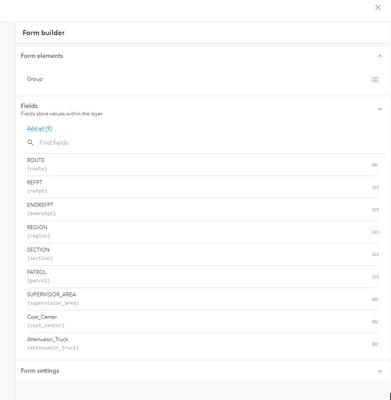

doronwen
@Laura I do not see that option in my Form  Builder tab:
But I see the relationship in the my Content folder, including the Service definition.
Am I missing any settings? Permission?
Laura
by MVP Regular Contributor
The table is in the map along with the layer right?
doronwen
@Laura Correct. I have both feature layer and the table in my map. (I think that's what you're asking, sorry)
Laura
Yes. Hm that is not expected behavior..
You added the related record to the pop up too? I'm not really seeing what is wrong.
Is there data in the table yet? Correct primary and foreign keys for the relationship?

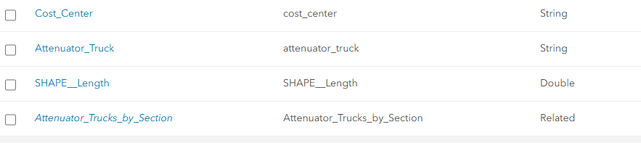

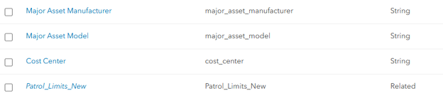

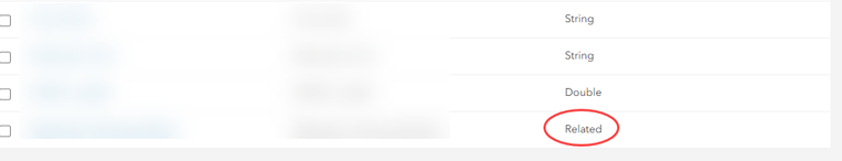

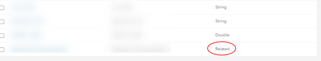

doronwen
And I see my related field under Content, Data>Fields
Table:
Hosted Feature layer:
doronwen
Pop-up menu has the same behavior - I do not see the option to add related fields.
Is there something in the settings I need to change? The hosted feature layer is edit enable. Not sure if that makes any difference.
