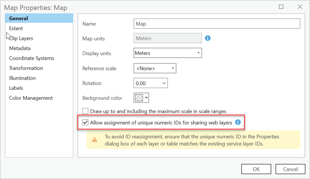

Ever since going to ArcGIS Pro/Enterprise Portal, I have been having difficultly with publishing services to our Enterprise Portal.  I'm not sure if this is a bug in Pro, but if you have 'Allow assignment of unique IDs for sharing web layers' unchecked in the map properties within the Table of Contents and want to share feature service, it will always have it checked, throwing an error before you share.  This might be a feature that is done on purpose?  Not sure. But every time I overwrite a layer, I have to uncheck the box.

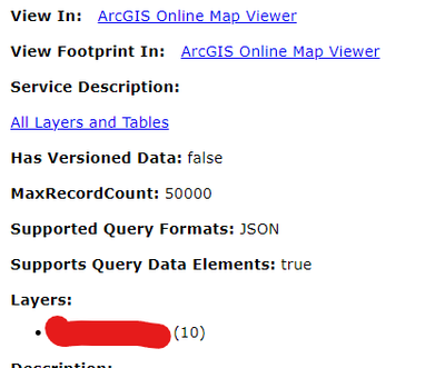

But the real issue I am concerned about is when I don't allow for unique ID's and create an independent service for each layer I share, I've had instances where the unique ID will change (from 0 to 10) after I have overwritten the service. I'm doing something simple like changing the source of the layer from a view to a static table or including new fields.
This is frustrating because it literally breaks everything I have, web apps, maps, dashboards, etc.  Luckily, I can use the AGO Assistant to solve this, but it makes me nervous when I am working with very important information that needs to be updated.

What you have described is not a bug in ArcGIS Pro. It sounds like you are encountering error 00374: Unique numeric IDs are not assigned. The error was intentionally added to prevent you from sharing or overwriting web layers before assigning IDs to layers or tables in your map. If static IDs are not assigned that match existing service sublayer IDs, the IDs may change as you observed. If you overwrite your service, this may break web maps and other web apps using the service. (This is the situation you described with the broken apps and dashboards.)
The solution here is to assign static layer IDs to your layers and tables that match existing service IDs. You can read more about this in the help topic, Assign layer IDs.

But I don't see the setting to assign static layer ID's in the layer properties under General?
JonahLay
First, enable Allow assignment of unique numeric IDs for sharing web layers.
The Layer ID text box in layer properties will appear.
