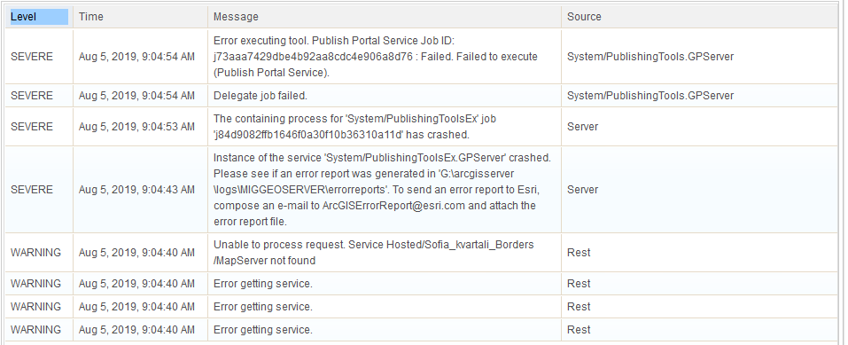

This morning I found my server machine restarted (maybe due to power fault or something other unexpected). As I expected, now I cannot publish hosted layers again. All the times so far it is always the same type of error:
The ultimate error which I occur every time

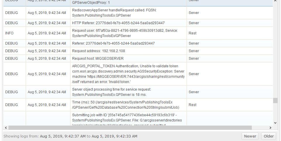

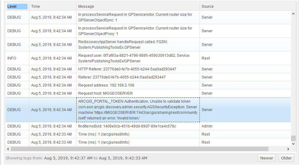

I also tried to validate the Server within Portal. It give a green tick (validated), however I explored the debug logs in Server, and the following appears:
Is this a problem of some TOKEN that vanishes after changes in the system?
Is there a procedure, e.g. command line utility program or something else that can help restart this service. Or maybe some lock files are written somewhere and they forbid access to the GPServer after any change in the OS settings. I tried to restart Portal, Server and DataStore services in Windows Server, but the problem persists. I really cannot figure out why this service crashes in various cases.
