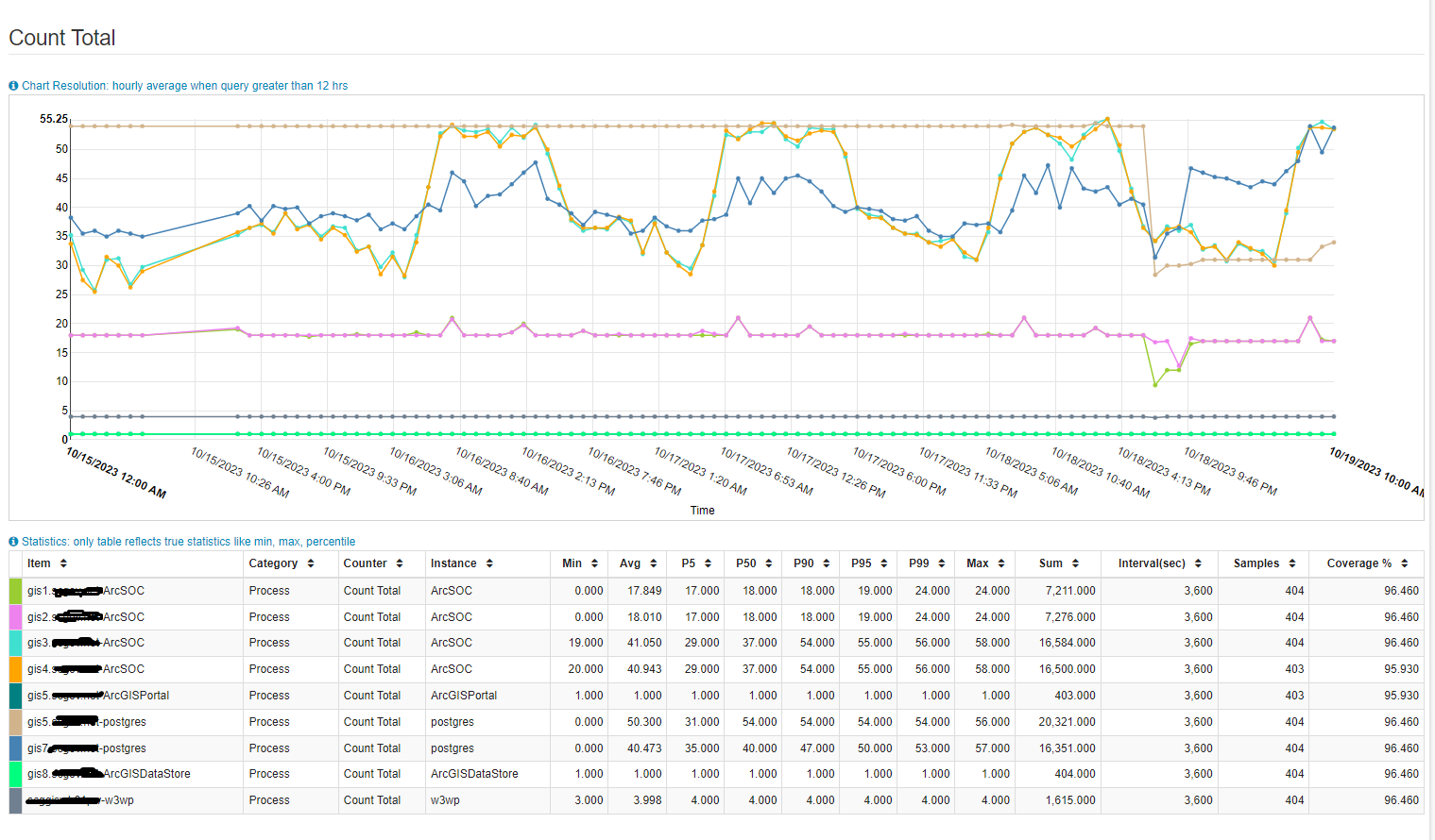

Hello - I've noticed recently that the the postgres.exe processes are not releasing in Portal at the current 11.1 relesae.
That is, I have a counter set in Monitor that shows the process counts only increasing:
Here, the graph shows for the week, the datastore (gis7) postgres counts increase and decrease as the day progresses and layers are accessed and released.  But for the portal (gis5) postgres counts, those only increase until we either restart the portal service or restart the server.
I feel like before a 2-3 months ago, the postgres.exe processes would release, same as they do in the relational datastore.
Is anyone else noticing this behavior?
