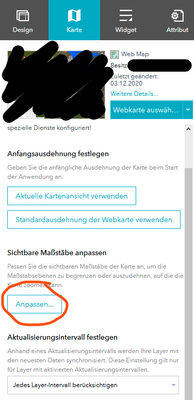

I haven't found any applicable options in the web map. But if you use it in a web app, you can configure the visible scales there.
Have a great day!
Johannes
