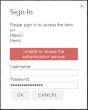

      • New Development: Users can no longer sign in with prompt. Shows "Unable to access the authentication service." error.
        (see screenshot below)

BUT, I am now still being prompted to sign in not only for hosted data, but referenced as well. Even if I sign in as the data owner, I get the prompt.
I tested with my colleague who signed into the same machine with the same credentials, but did not get the sign in prompt at all....
So I am guessing that it might be related to my windows credentials???? I am going to check that out, but I am still lost as to why this is happening.
