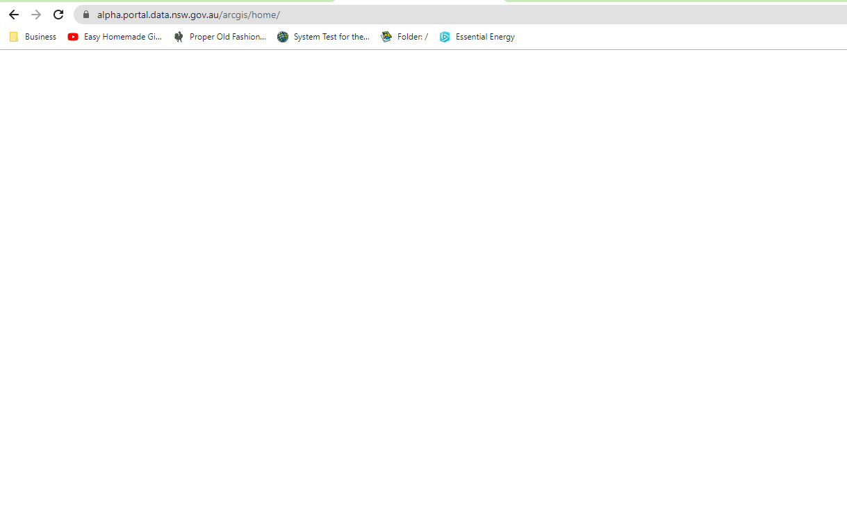

We are running portal 10.7.1 and 10.8.1 and when using it in Chrome (Version 90.0.4430.212) we are regularly getting a blank screen. I doesn't matter what page I access (home, content, etc) the result is the same. If I clear the browser history it comes good but want to find out if there are ways to stop this happening as clearing the history is not a very user friendly solution. It will work fine for a few days and then I need to clear the browser history again.

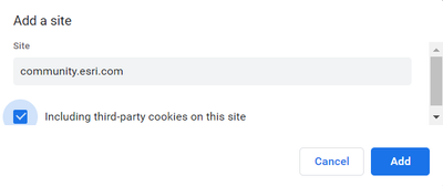

But one way to automate the clearing of cookies specific to your Portal website is as follows.
In Chrome Settings > cookies (chrome://settings/cookies),
add your Portal website to "Always clear cookies when Windows are closed".
Although, I assume you already know this step.
