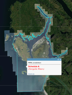

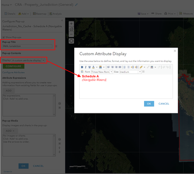

What I mean by customized popup is that for a feature class that has no significant database attributes I simply customize the information in Portal so when the user does indeed click on the polygon they at least see something that is more meaningful than OBJECT ID, SHAPE, etc.
 So in this case, when the user clicks on this area they will see something meaningful (I just find it easier to do this than to update fields in our geodatabase):
This is also the layer that is causing me grief.  Sometimes it shows up (like it does now), and other times it's the only layer of the 5 in this map service that doesn't show up.  But if it's the customized popup that is now causing the problem, then updating the attributes in the feature class would be an option.  I would first like to determine what is causing this problem though 😎.
