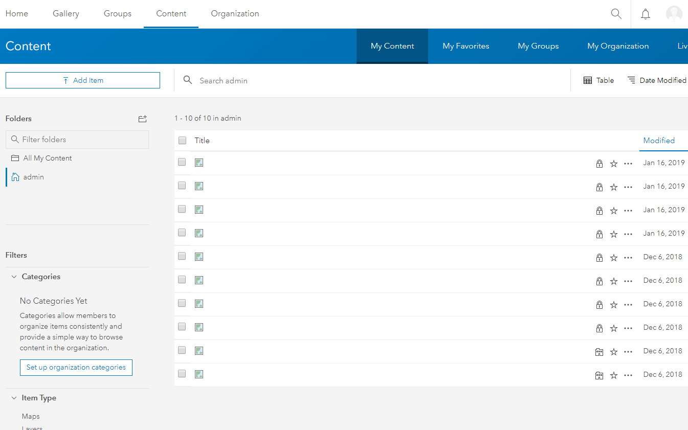

I have upgraded ArcGIS Enterprise from 10.6 to 10.7.1 recently and noticed that the Portal items are somehow corrupted upon completion of the upgrade. The items have no title or thumbnail. The item properties page just spins and never actually comes up, and opening the item properties from the Sharing Rest site gives a 500 error. Most of these items are map services that reside on the federated Hosting server. Reindexing the content did not help. From within ArcGIS Server, I can see that the map services are behaving just fine. The issue is with the Portal items themselves. Has anyone else experienced this issue or anything similar?
Hi, after upgrading to 10.7.1 we have a similar but different problem: all services disappear from Content panel and all the folder seems emply.
Also searching from Gallery page (using filters as tags or categories) the problem persists.
In our federated argis server the services are still active and working.
Also trying to add a new element from portal , publishing process works but the new item is "invisible" trying to search for it in gallery or content page....
