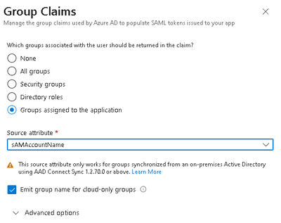

Chiming in here with what worked for us. We're still on 10.8.1. I got our organization AD IT specialist involved for the Azure AD admin center stuff.
1) In Azure Active Directory admin center, we added a group claim to the Portal application and configured it to use "Groups assigned to the application" and the Source attribute of "sAMAccount Name". I think returning only the groups assigned to the application resolves the issue of a user being a member of too many groups (as not all their groups will be returned, only the ones associated with Portal in Azure AD). This gets done once per application (i.e., per Portal - if you have Dev, Test, and Prod you would set this up three times, but once it's set it's set for good).

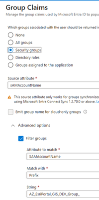

We use a different way, and this is to set the group claim to 'Security groups' option and then in the advanced section add a prefix filter. This way you don't have to keep adding groups into your enterprise app and only the AD groups you actually require are passed in the group claim. A little bit naming standards need to be done for this to work.

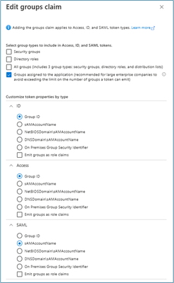

Configure group claim
This should only need to be done once for the entire Portal, although I’ve had to re-do it after upgrades, so … {shrug}. I think you will need to do it for each Portal in a Dev/Test/Prod scenario.
Go to Manage > App Registrations in the left side column
In “All Applications”, search for and select the name of your Portal application (note that this may be slightly different than what you call Portal in the Esri space – talk to your Azure admins if you need help finding the right application); this will go to a new page
From the (new) left side column, select “Manage > Token configuration”. If you do not have permissions for this, click on Manage > Owners” and contact one of those folks to grant you access. In my experience, any owner can add another owner but talk to your IT Azure administrator(s) to be sure that’s okay in your organization.
Click “Add groups claim” and configure:
Your exact interface will depend on your Azure version.
My organization's interface configuration as of 03/2025:
