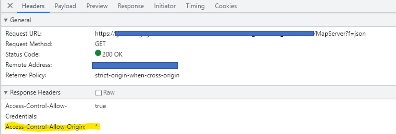

1. https://myserver.onecompany.com/arcgis/rest/services/foo/MapServer?f=json    => 200: no issue
2. https://myportal.company.com/geoportal/sharing/rest/portals/checkurl?url=https%3A%2F%2Fmyserver.onec...
=> {"success":false,"error":{"message":"Error checking resource"}}
And it retries for ever...

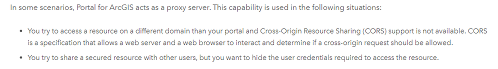

But according to the documentation of this parameter, this proxy server is used in the following situations:
https://enterprise.arcgis.com/en/portal/latest/administer/windows/restricting-the-portal-s-proxy-cap...
The thing is that "myserver.onecompany.com" has CORS enabled and is an open data one with no credentials involved so no need to use the Portal proxy:
This means that every time a user wants to add a layer from URL, he will have to contact us to whitelist this domain even if CORS is enabled. Seems like a bug to me or did I miss anything ?
