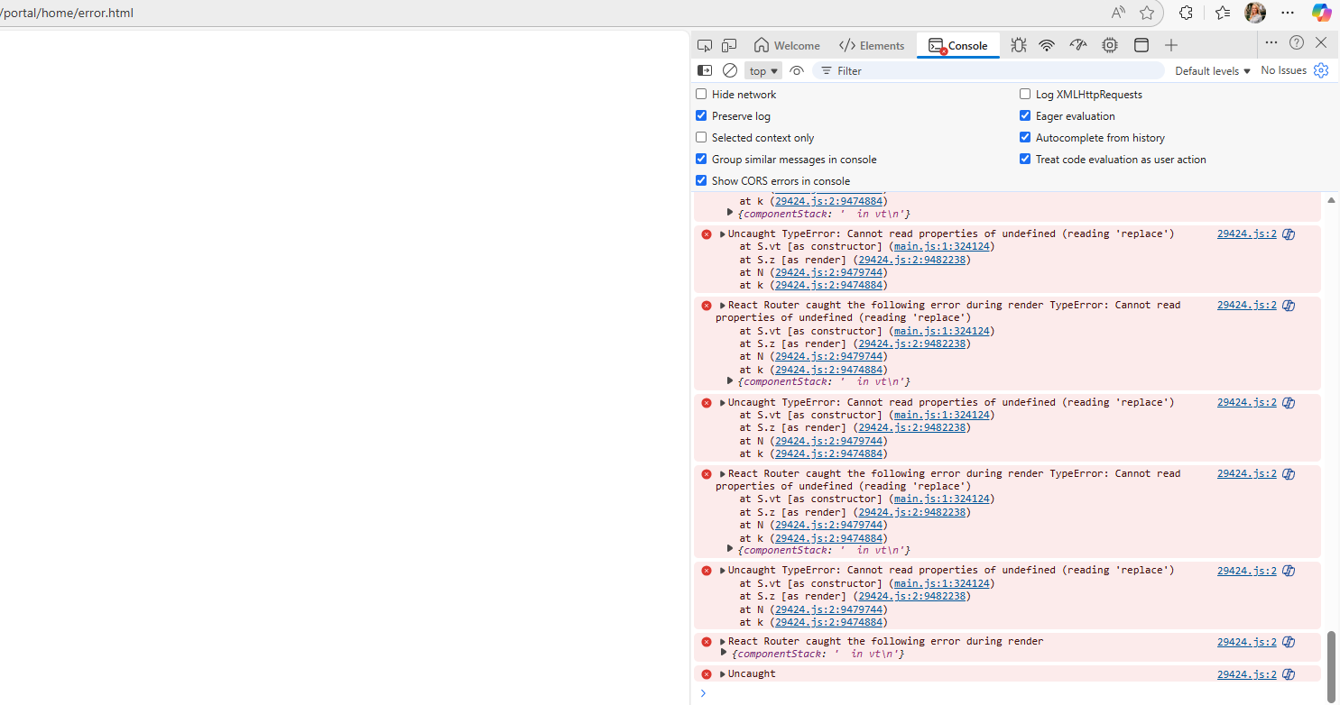

I just upgraded my Portal from 11.1 to 11.5 manually - this was successful, until i tried accessing my Portal home page at https://my.portal.com/portal/home, I am then redirected to portal/home/error.html without any further errors. This also applies when I try locally with FQDN, so not a WebAdaptor issue in my eyes.
However, I am able to reach portal/sharing/rest and /portal/portaladmin without any errors. And yes I have tried:
  • restarts
  • clearing my browser cache several times
  • updating my browsers (Edge and Chrome) to the latest version
  • private window
Anybody else have encountered this issue before? Thankful for any tips
