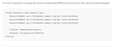

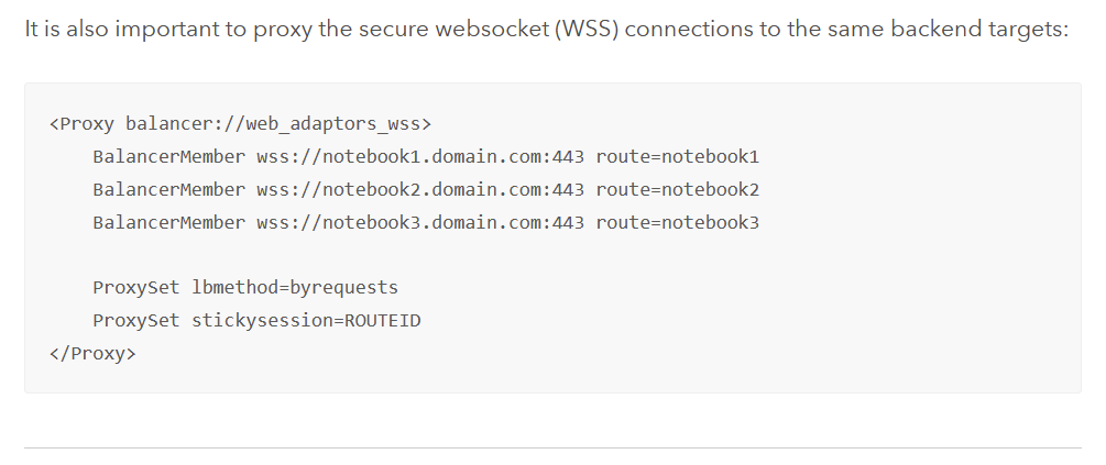

Recently, I've experienced quite a few issues regarding the ArcGIS Notebook and connecting through out reverse proxy. We are getting constant WebSocket issues after changing the DNS name of our reverse proxy address. I was curious if anyone has an example of this here:
I was not able to replicate this, and I believe the documentation is very outdated, even though it is for 11.2.
