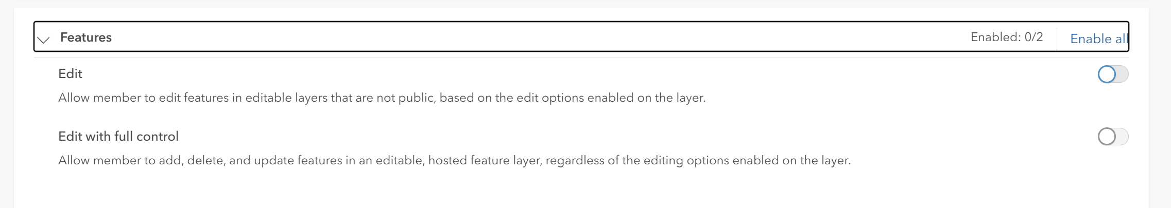

On our Esri portal instance we have a custom role 'AP - Data Collector'. This role has been configured in such a way that Features cannot be edited
However, when attempting to test that this is the case by logging in with an account with this role, the user is able to edit the view layer data as shown the screenshot below:

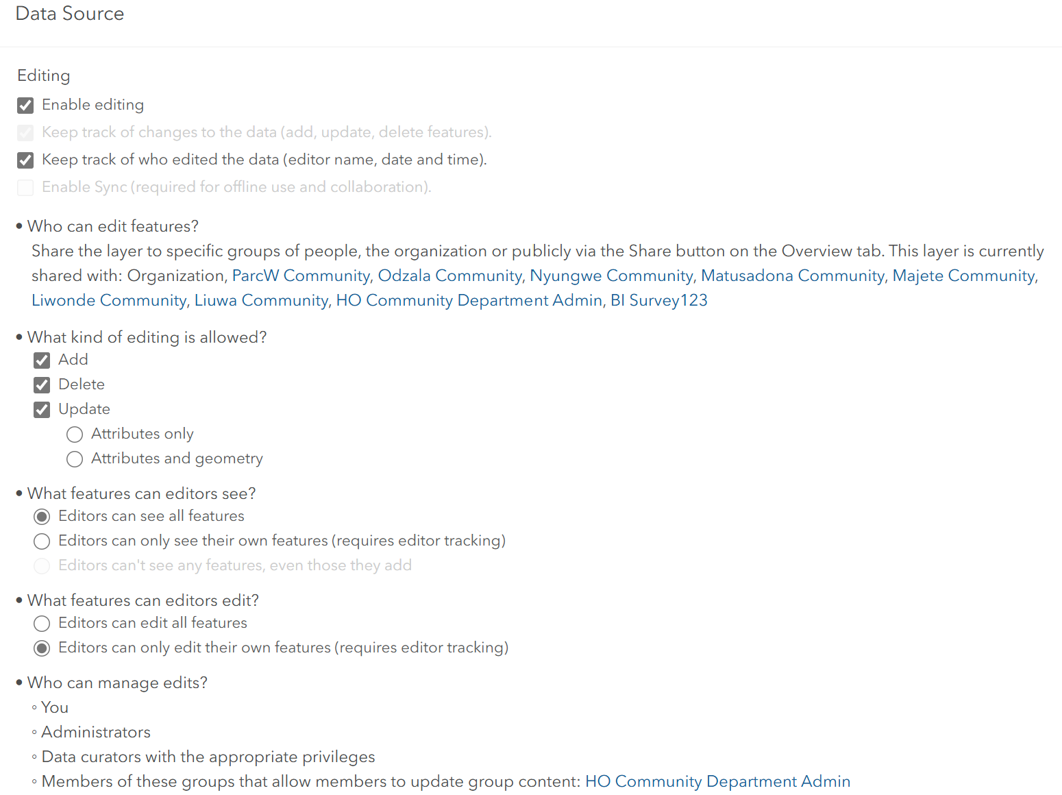

The feature layer's data settings are set up to allow edit-enabled roles to edit the data, as per the screenshot below:
Is there something we are doing wrong or misunderstanding, and how can we alter the settings or role to ensure users with this role can only collect data (through Survey123) but not edit data, or are collecting and editing the data synonymous?

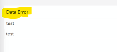

If you actually edit the data, does it let you save it? The reason I ask is because I can replicate this behavior, where a user with no editing privileges gives the appearance that you can edit (by clicking the attribute value and it giving you the ability to type something different). However, if you change the value and then click elsewhere to save the change, a "Data Error" will appear. Do you receive the error or does it actually change the value?

It doesn't actually save the value. We should've tried that. Doh!
