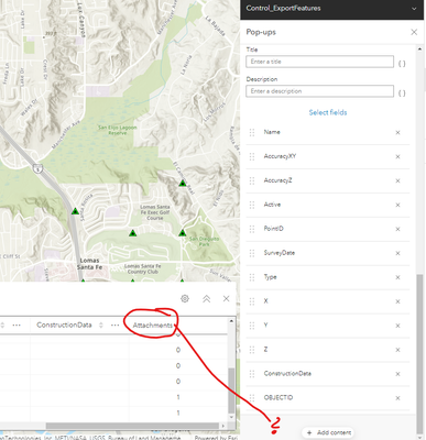

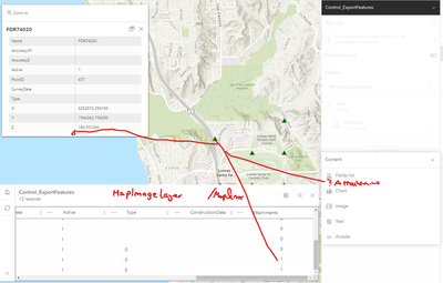

I encountered the same issue:
I added some attachments to a demo dataset, that is published as MapImageService. /MapServer/

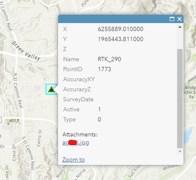

In the Map Viewer Classic, the attachment shows up in the popup and can be configured. The Attachments field also shows up in the attribute table.
In the new Map Viewer, the attachments field shows up in the attribute table, but it is not possible to configure this field in Pop-ups.
