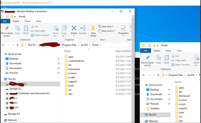

Hi, I am running as the administrator for new install of ArcgisPortal 11.0 . But I  get the error:
I checked the Portal folder but could not find the customizations folder. I have 10.8 version of portal  on different server, where I could find the customizations folder. Any reason why I cannot find the folder in 11.0?
BillFox
MVP Notable Contributor
Did esri send you the missing config.js file for 11.1?
saraswathiemani2
Nope. I created a customizations folder and the utility ran successfully and changed username.
