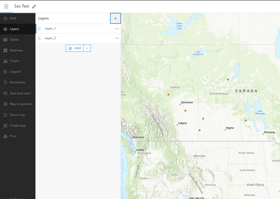

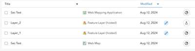

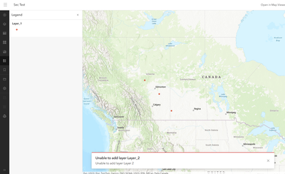

I tried a similar test to see if I could recreate, and I wasn't able to. I am thinking this may be an ArcPro or 11.1 issue (I'm on 11.3).
For my test layers, I created everything in the Portal. If you do that and have a similar result, it's an 11.1 issue. If you get my result, it's an ArcPro issue.
Layers:
Viewer Account:
Account with permissions:
Enterprise 11.3
