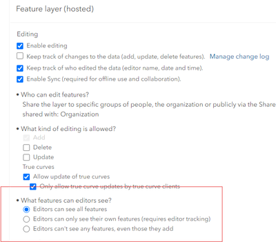

I have managed to resolve this issue in AGOL so not sure if it will be applicable but thought I'd reply anyway.
Under Settings - feature Layer (hosted), make sure "What features can editors see?" Has "Editors can see all features" selected.
