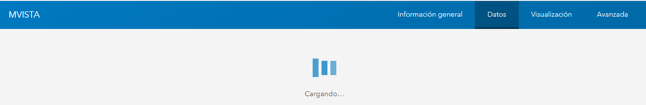

Dear community, when I publish a map through ArcGIS Pro, all the layers are contained in a single service renamed as "_WFL". This is very annoying, especially when I want to use one of the layers in another map and not the whole set of layers.
The problem becomes even worse, as I only want to share one layer from "_WFL", I went into the container and selected the layer of interest to create a view, the view layer is created correctly but when trying to open the view, it stays endlessly loading and does not show any data and when trying to load it on the map, it doesn't show anything or gives an error that indicates that the view cannot be loaded on the map.
Please help me or provide me with any other ideas.

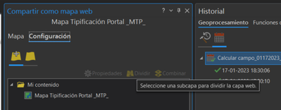

PlaninforAdmin
Thank you for your response, but the "divide" option is not active for me. It seems that I have to select the layer first. However, the content panel is not showing any other elements, it only shows the map.
