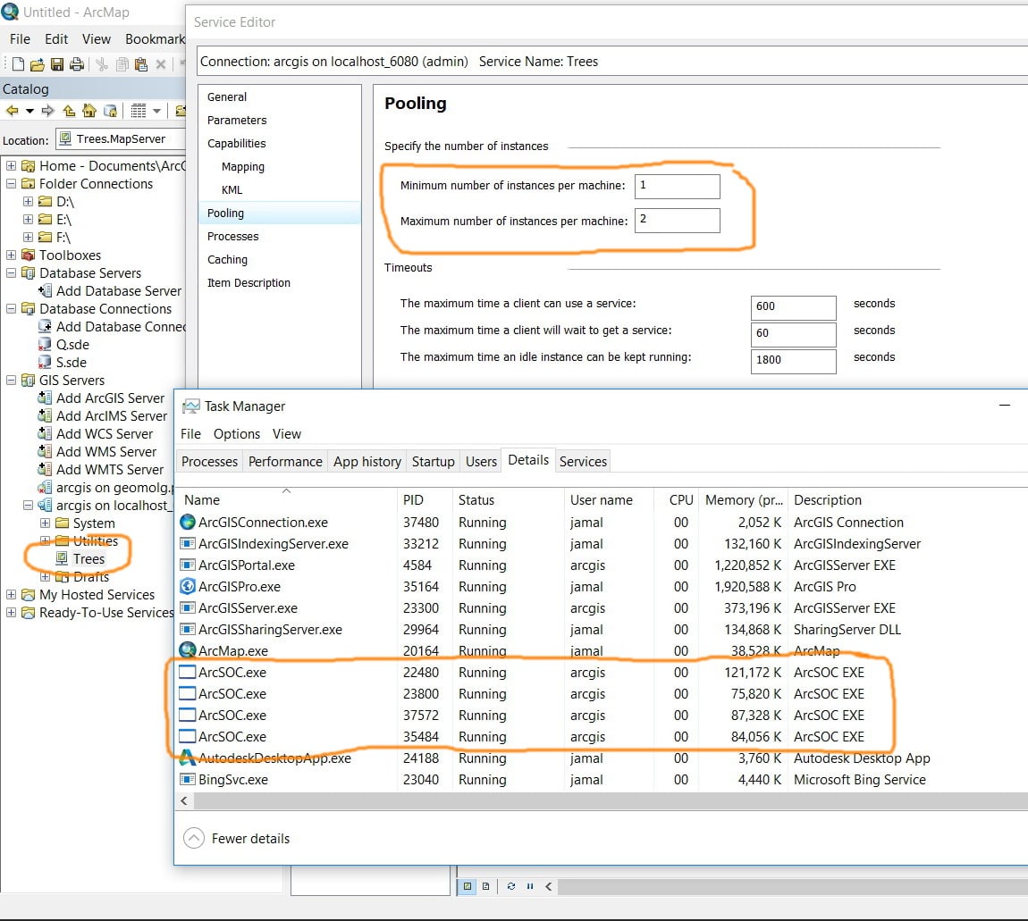

Is there a limitation for publishing in ArcGIS Portal,
1333
11-10-2017 03:38 AM
JamalNUMAN
Legendary Contributor
For example, the maximum number of ArcSoc.exe that can be published in ArcGIS Server is associated to machine resources as follows:
Recommended number of ArcSoc.exe ≤ 4 * number of cores
Recommended RAM size ≥ 3*number of cores
