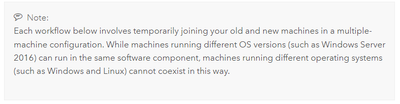

Unfortunately, I don't believe that migrating between different operating systems is possible, per documentation:

That's my understanding as well.  Same as no current migration path to Kubernetes.

I belive the exportsite output has the configurations of the various file stores etc, machine names etc and that these will be linux/windows/kubernetes specific.  You would be looking at something like ArcGIS Online Administration Tools or a third party tool to migrate the content, rather than the whole of the internals.
Sorry, I can't be more specific as I only support Windows based platforms.
