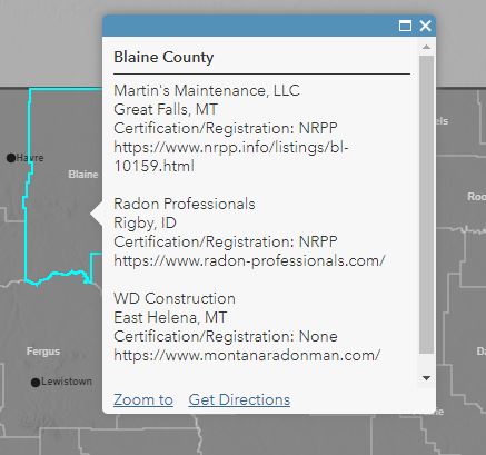

I have a hosted feature layer with a related table. I am populating the popup for the hosted feature layer with an attribute expression that is pulling information from the related record. One of those attributes is a website url.  The expression to do that is below. My question is how can I have the website url read as a clickable hyperlink in the popup. Currently it is just unformatted text with no hyperlink. Thanks in advance!
