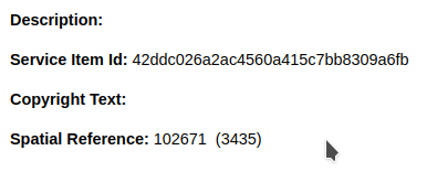

You're certain the items are not in your Portal? If you go to into the REST directory and look at those items, do they show anything for the Service Item Id?
- Josh Carlson
Kendall County GIS
SimonSchütte_ct
MVP Regular Contributor
Yes, I tried that, but I get "Item does not exist or is inaccessible."

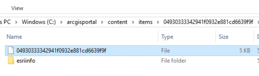

The item will be present somewhere in your Portal - as you say, querying "item=049876123786128763" will  not resolve to any item. What will be identifiable is the item link to "item=049876123786128763" - please try to identify what the orphaned item is.
Ultimately, the best way to resolve this is to delete it and recreate the item. Please get in touch with ESRI technical support for this as sometimes it must be done from the command line.
Tip to identify item, you can open the item file in the arcgisportal directory:
