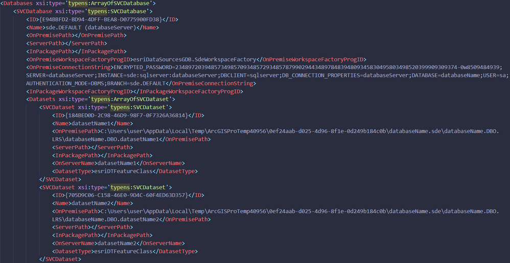

Another way that you could do this is to look at the manifest.xml file for each of the services in the ArcGIS Server configuration store directory, e.g. D:\arcgisserver\config-store\services.  This includes a list of all of the databases/datasets used in the service:
You could just search across the services folder, or maybe do something to programmatically pull these details out if you're looking for a more elegant solution.

Further to the response above re the xml - this is actually exposed in the admin REST admin.
https://developers.arcgis.com/rest/enterprise-administration/server/servicemanifest.htm
Example:
https://machine.domain.com/webadaptor/admin/services/Maps/California.MapServer/iteminfo/manifest/man...
You can see the response from the developers link above.
You could write a pretty simple python script using requests. If you are familiar with the Python API then this info is also exposed via the ItemInformationManager. It would be pretty easy to sketch up a Jupyter notebook that could pull this info out for a given GIS.
https://developers.arcgis.com/python/api-reference/arcgis.gis.server.html#iteminformationmanager
property manifest
The service manifest resource documents the data and other resources that define the service origins and power the service. This resource will tell you underlying databases and their location along with other supplementary files that make up the service.
