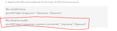

Thanks for the info! I'm using notebooks within ArcPro on a machine within our network. After trying to connect to our Portal, I receive this message.
I'm on step 2 of this guide - https://support.esri.com/en/technical-article/000022252
I've entered my portal URL and my username and password.
Is there something different I should be doing or does something need to happen on the Portal end to enable access?

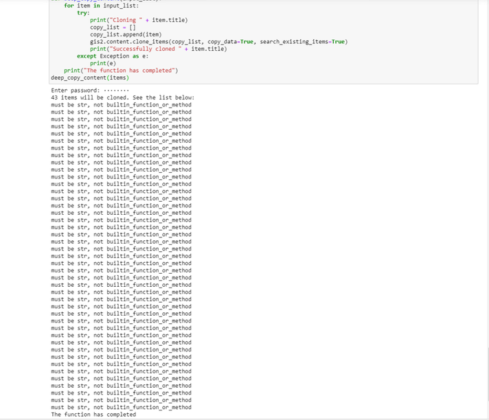

That worked. I ran the final steps of the process and it came back with this message:
I also don't see any new content in my AGO account (I'm moving items from our Portal to AGO)

I think you are passing a full list, where clone_items wants a single object.  I suggest iterating through your list of items to be copied and calling clone_items for each iteration
DaveK
Hey @ReeseFacendini
I believe I'm passing a single item into the script with just the item ID. If I still need to iterate through my items, how would I do so?
Thanks.
ReeseFacendini
Esri Alum
The line where you are calling clone_items within the try / except block,  you are passing a list (even though it only has a single item in it).  Change the line to read "gis2.content.clone_items(item, copy_data=True, search_existing_items=True)
