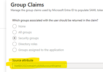

The claims section in Azure AD was altered and now showing in the format of <domain>/<groupname> which works a treat.

AnthonyRyanEQL
Sorry about being 5 years late to reply. In the group claims section in Azure AD, we changed the Source attribute
