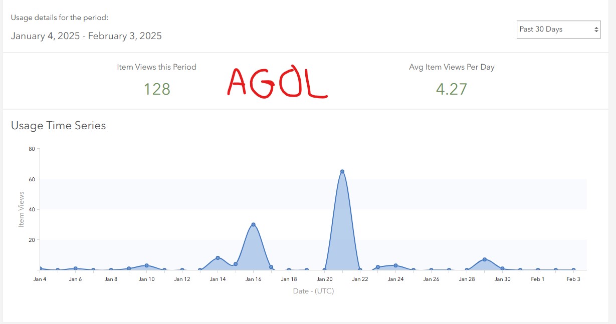

Is it possible to get view counts and usage information for Map Applications, Web Experiences, and/or map services from ArcGIS Enterprise (11.3) and our own federated arcgis server services within a specific date range? I've found we can get reports that include view counts, but those view counts are just for all time from what I understand. The way AGOL makes available usage statistics within a date range would be very perfect for reporting purposes (see screenshot) required for the higher-ups in my org, but all our authoritative content is shared from our portal site.

@imansbburg - there isn't the equivalent of the item usage report in ArcGIS Enterprise. This FAQ lays out some alternatives, but as you note, the per-item usage values are all-time, not for any particular period. For services (as opposed to maps, apps, and other content), you could use the statistics tab in Server Manager, which can limit the scope to particular dates.
