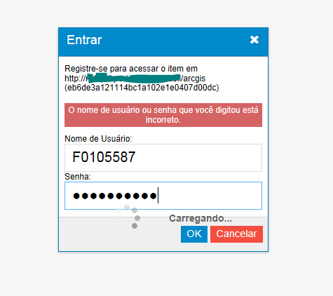

This is my web application with the error:

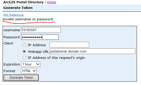

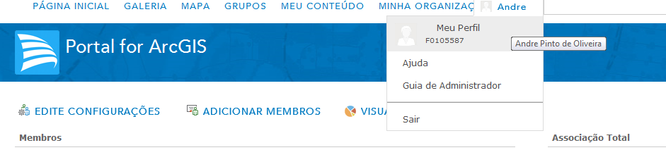

The user and password is valid and also I can login with same domain account into the portal directly.
But when I try to use the GenerateToken Rest Service I receive Invalid username or password.

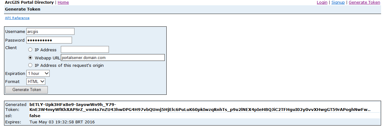

I can generate token with my Administrative acount (arcgis) normaly.
