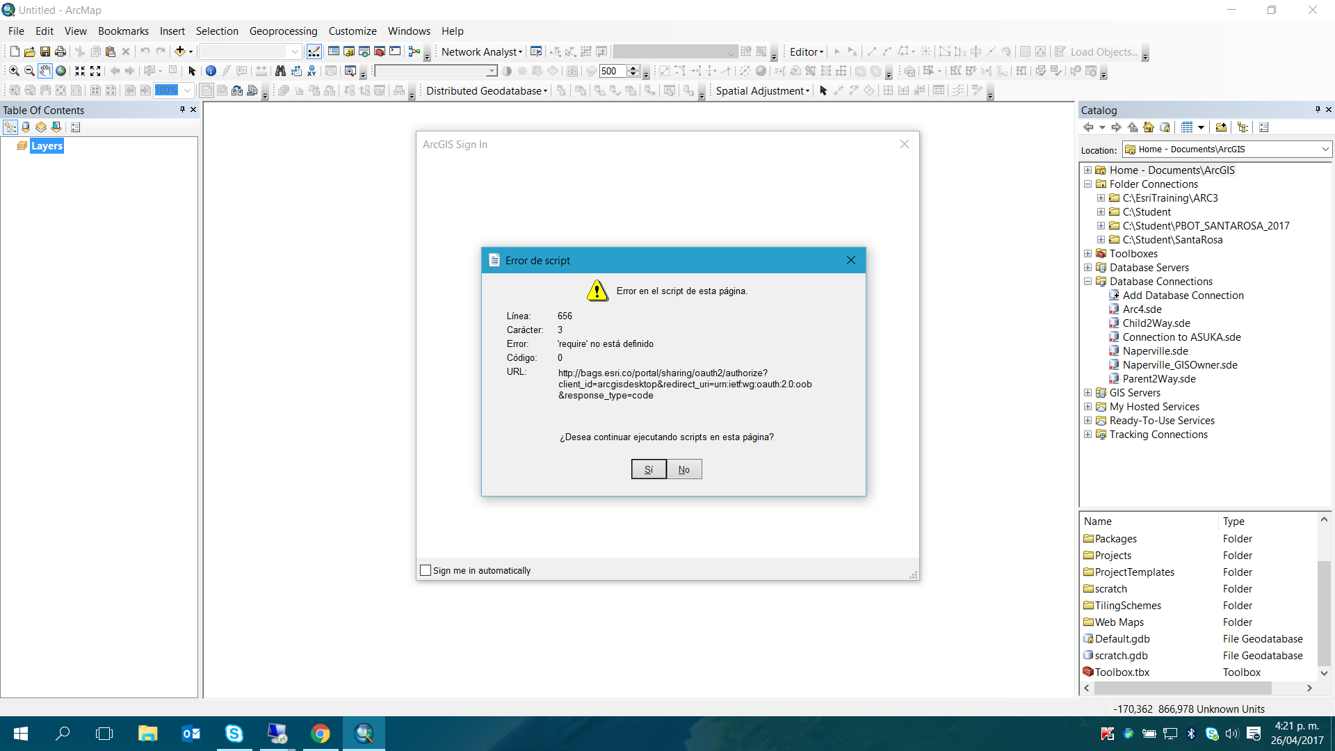

I have a portal for arcgis 10.5 in azure and when i try to connect from arcmap i get this error
I have all the SSL Certificate working good and the portal work very well from Chrome, but when i try to connect from arcmap i get this error, if some one can help me to solve this, Thank you.

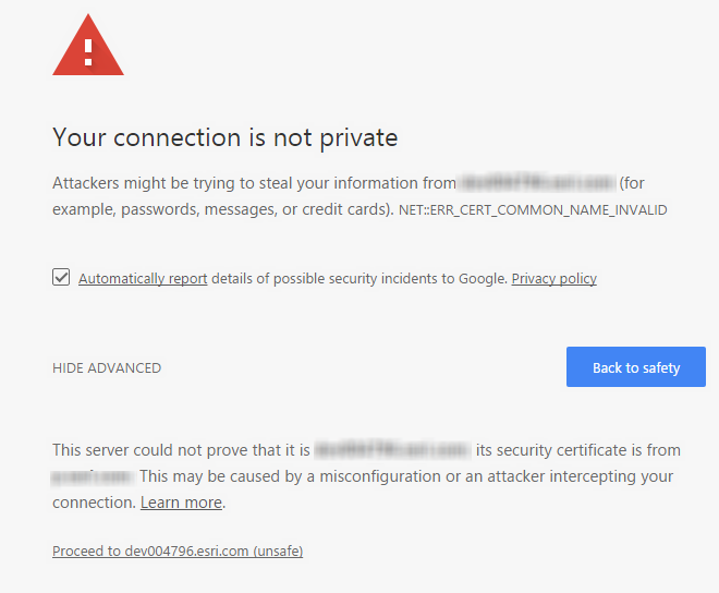

Do you see certificate errors when reaching the portal through https in a browser? If so, what are they? The example below is from Chrome and it's a certificate mismatch error:
No i dont get any message like that, the certificate its working good and in browser the portal works very well , but when i try to connect to the arcmap sometimes i get this image
And other times i get the message i show in the question, i have all the ports open and the arcgis server publish good from arcmap but then i try to publish i hosted services in the portal and i cant because i get those messages.
I would run Fiddler when you try to make a connection and see what specific request fails. ArcMap uses the trusted certificate store that IE and Chrome use, (even though Chrome is a bit more picky about certificates), so if you don't see any certificate errors when using IE, then ArcMap should have no problem. Anyway, Fiddler will be a good tool to use for the Unable to connect error.
