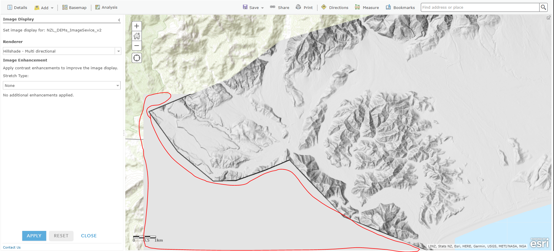

  • Areas of no-data seem to be rendered as grey when they should be 100% transparent. Red circled area in screen shot below should be no-data.

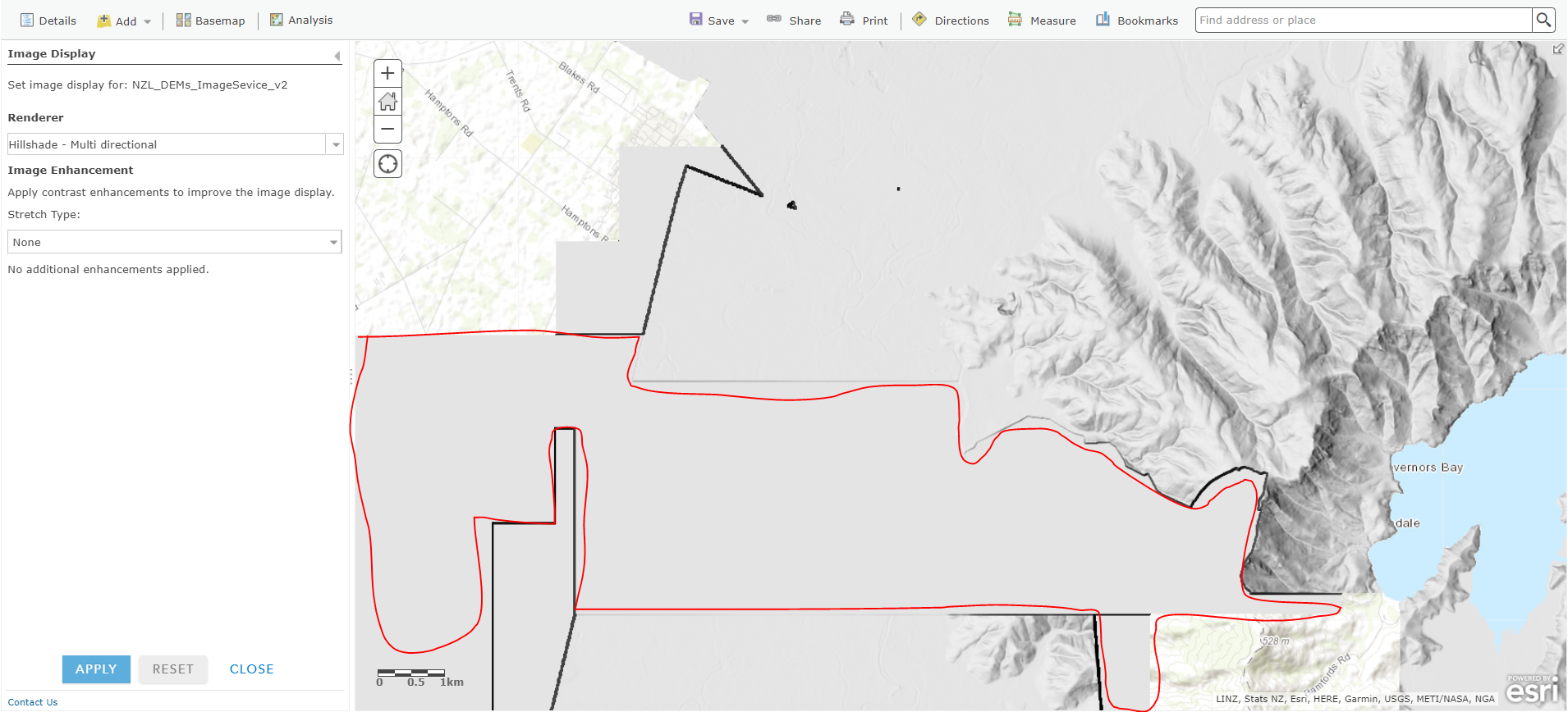

This becomes an issue where 2 overlapping areas of terrain data meet. Circled area shown below should be transparent showing terrain detail from other DEM rasters.

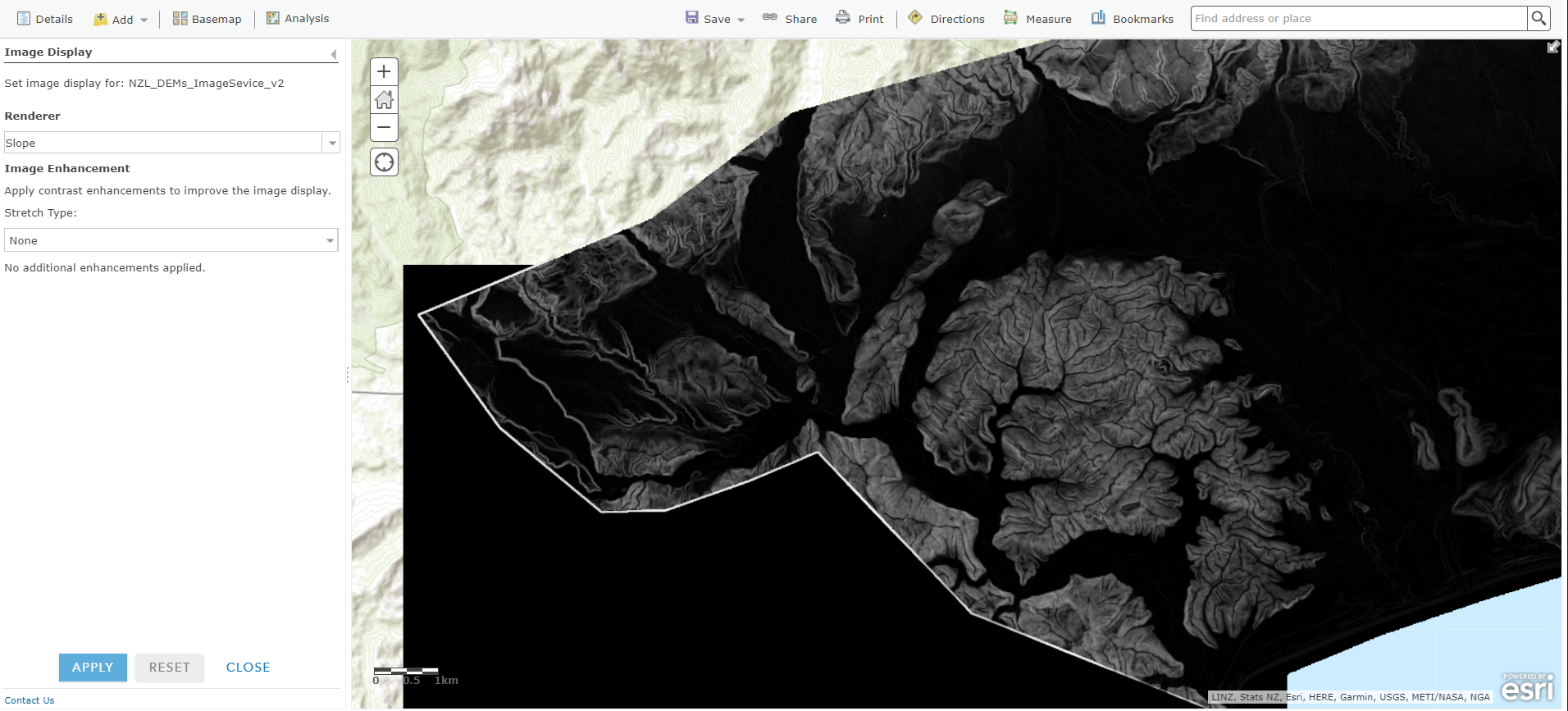

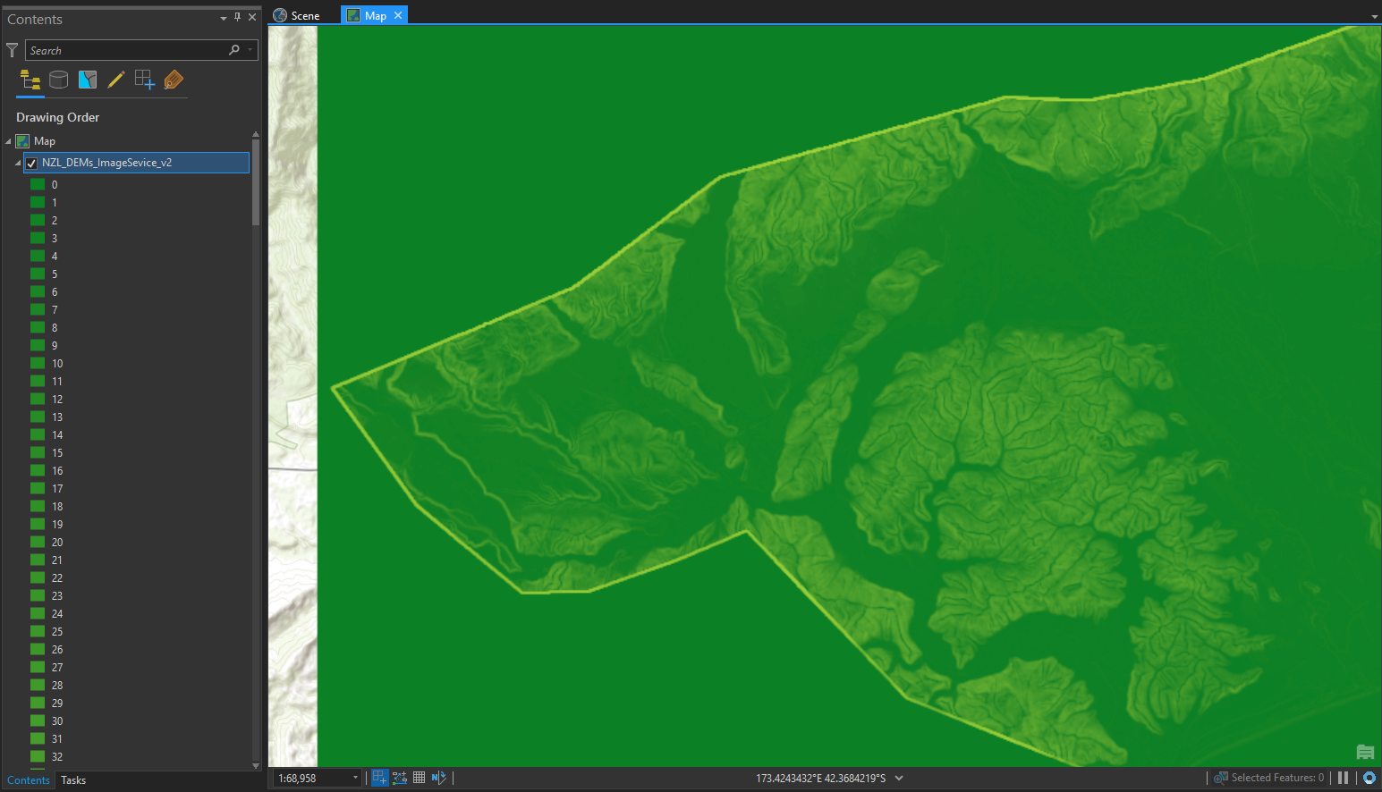

  • I set the Slope raster function to have a green to red color ramp, but in the map viewer it has a grey scale color ramp (ArcGIS Portal 10.5). In ArcGIS Pro the green to red color ramp is shown as expected. Note the black and green areas that should be transparent no-data.

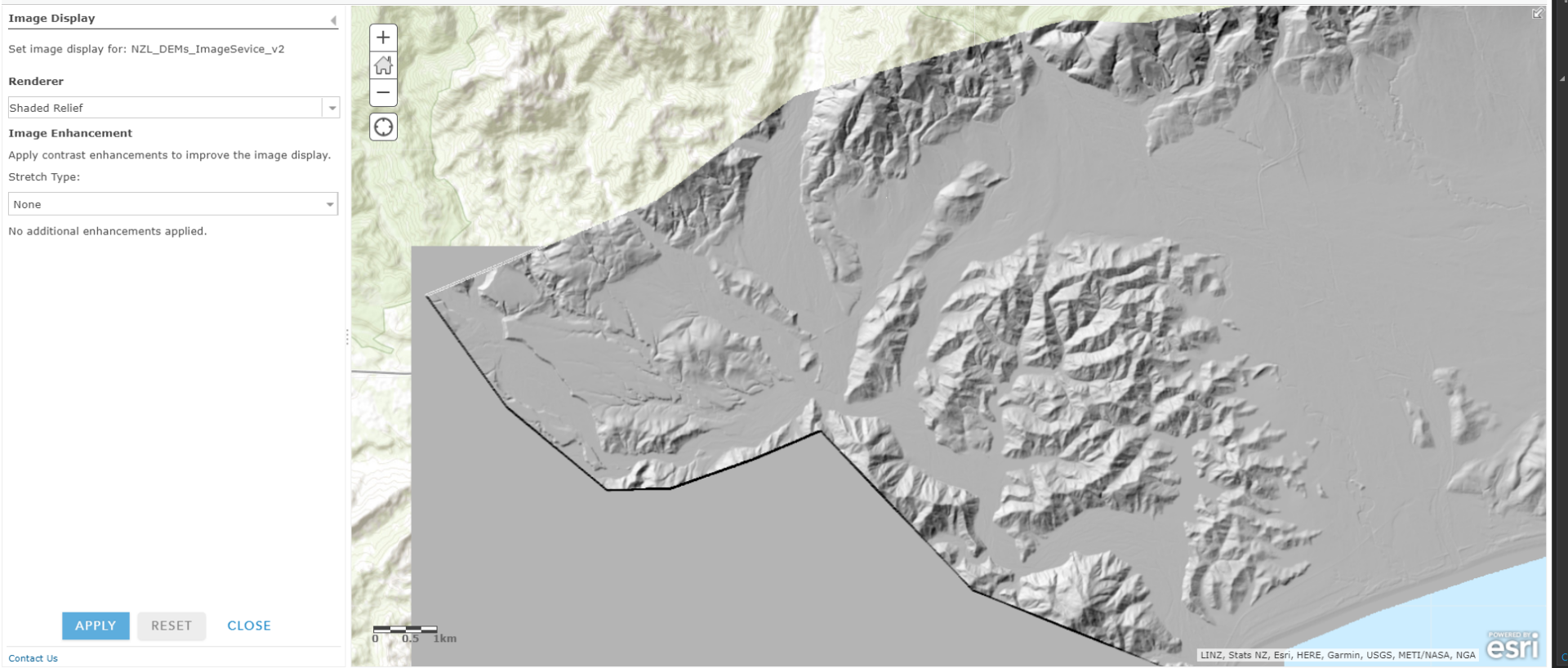

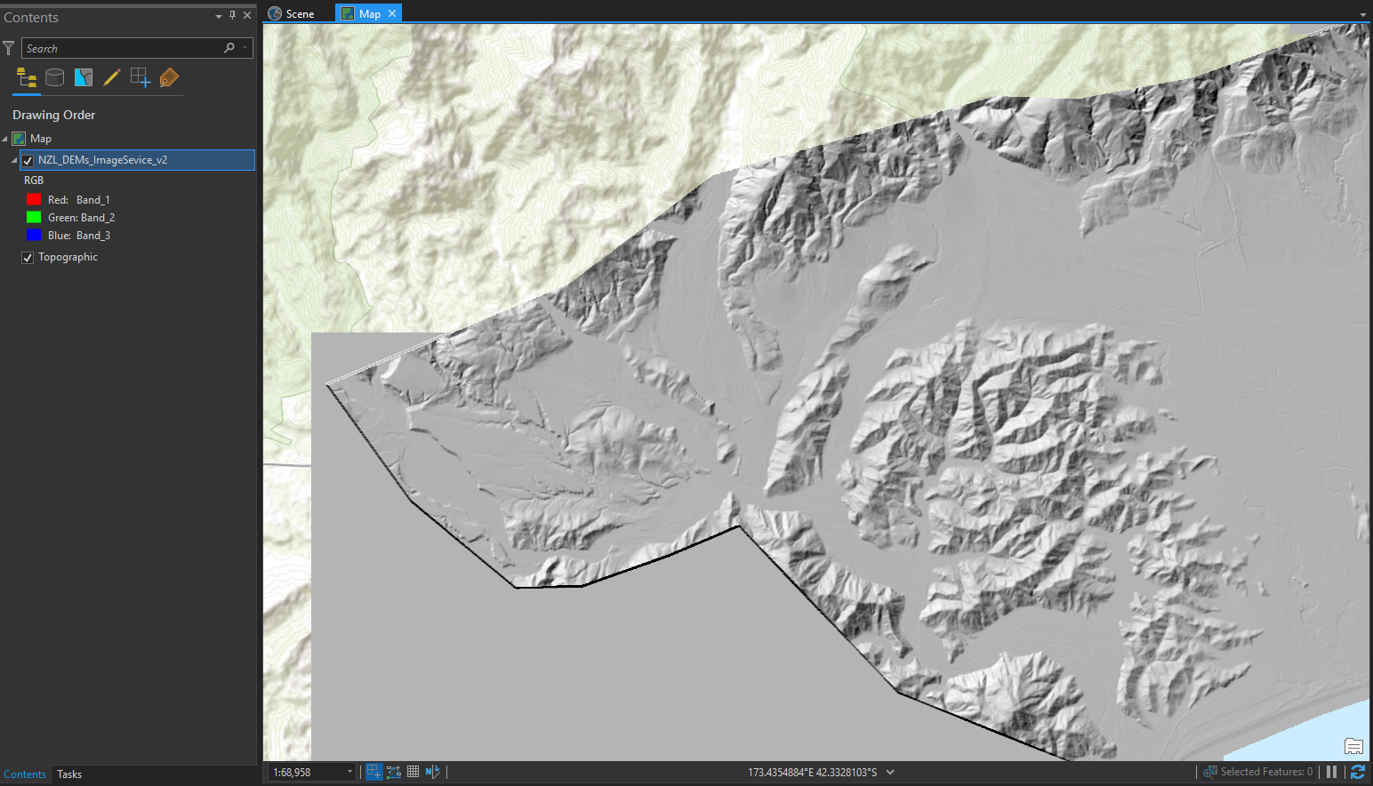

  • The Shaded Relief raster function should show a color ramp over a hillshade, but in both the web viewer and ArcGIS Pro I see the hillshade with no color ramp. I briefly had the color ramp draped over a hillshade working in ArcGIS Pro, but that's not working for me now.
