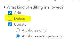

When you host a feature service in Portal you can go to settings and turn on/off if features can be deleted (see below)
This option does not exist when the data is referenced from a registered sde geodatabase. When publishing from ArcGIS Pro there is no option for this either, I seem to recall there was in ArcMap where you could select using check boxes. I do not have access to ArcMap and required to publish via ArcGIS Pro.
I need to prevent users from deleting features and leave them with the ability to only edit current features and add new features. The data cannot be hosted and must be via a registered sde geodatabase.

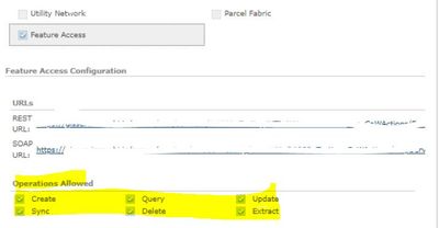

For non-hosted services, you'd manage the capabilities via Server Manager:

Thank you @JonathanQuinn
I had actually gone in there to try that and couldn't see the option to do that. But your screenshot showed me that I needed to highlight the Feature Access component.capabilities.JPG
Which then opens up those capabilities.
Thank you.
