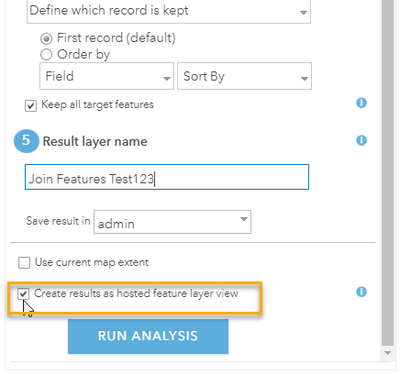

When you're running Join Features in Map Viewer Classic, are you choosing to create a Hosted Feature Layer View Join (by having this button checked?):
If so, that option is not available in the Join Features tool in Map Viewer.
If you do need your result to update as your input data updates, there's now a new way to create a hosted feature layer view from a join, located on the item details page of your target layer. You can check out the documentation here and this great blog post about the new method.
